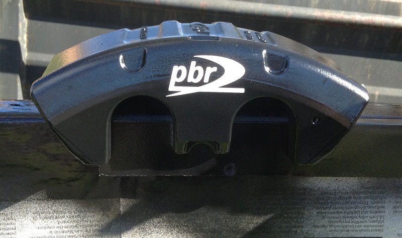

I have posted some photo's in this thread. Who know's PBR calipers ?
The red ones are the factory fitted Territory front calipers on a 322 rotor (I painted them)
The bare ones are the factory fitted RTV front calipers on a 298 rotor.
My 16" RTV wheels (CSA Spirit) do not fit over the Territory combination. Though they are high load rated wheel (900kg) so may be more substantial than some others.

'93 XG Falcon Ute( sold ) : '94 ED Falcon Classic ( sold ) : '04 Territory SX TS ( sold ) : '04 Falcon RTV BAII ute (still in the family)
